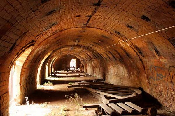

Green bricks were stacked on steel trolleys which were wheeled through openings into the kiln tunnel running around the lower level of the kiln. Look at the diagram below.
Cool air first passes through stacks of bricks in the tunnel that are gradually cooling after being fired. This pre-heats the air before it reaches the firing zone where fuel is burning. The hot air from the bricks being fired passes along the tunnel through the stacks of waiting green bricks, drying and pre-heating them gradually. Then the hot air is channeled by vents to the chimney where it rises, generating a low pressure zone that continues to draw air through the chambers of the kiln.

Kiln tunnel. Fuel was dropped into the tunnel through the small holes in the roof.Source: Palassis Architects Report, 2013
