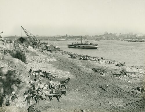

To the right the wharf is under construction. On the left the cliff is being cut down by men using horse-drawn carts for transport. The railway route through the site is the original North Shore line to Milsons Point. 18 March 1925. SARA NRS 12685.

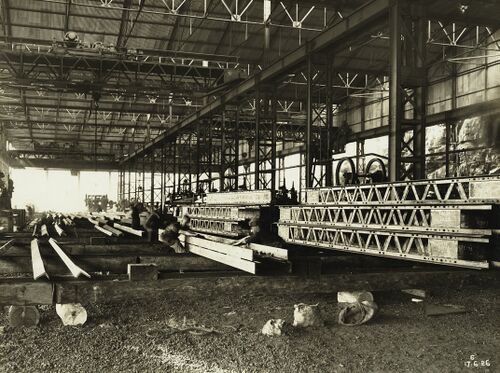

Bridge components stacked in the Heavy Shop. 2 September 1926. SARA NRS 12685.

Fabricating members in the Heavy Shop. On the left is a chord section. In the centre is the special cradle devised by Lawrence Ennis to safely lift the hangers, to rotate them to vertical, and then to position them under the chord where the crane hook could not directly reach. 22 August 1920. SARA NRS 12685.
